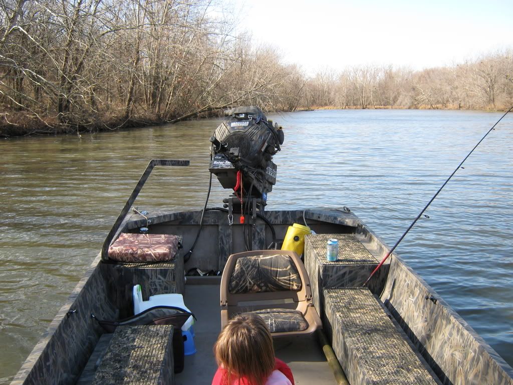

Some updated pictures... I finished my longtail build but have yet to paint it. But as of right now it runs!

Looks great. You really put in the time to do it right. How's your longtail push it?

Not bad, I can consistently get about 15-16 with the cavitation plate under the surface and have hit upwards of 18 by fighting the prop on the surface. Im still tryin to get the plate bent to the right angle.

how big is the motor and what prop are yu running?
