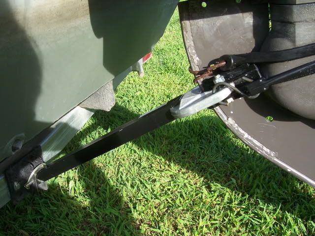

I got me a boat not made for a heavy PD so I went with an adjustable angled transom saver from Cabelas. That along wit a strap does the trick.

you have to buy the transome-saver and cut it to lenth and at an angle to accomadate your motor. I drilled my fin to hold all in place. looks like the same thing i did D DUCK

JP had a good idea and its the same thing I did with mine. Some stainless tubing and unistrut
