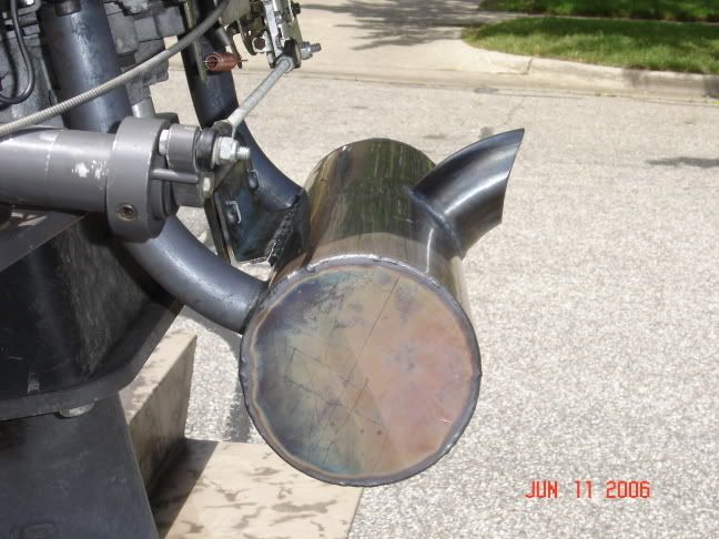

I made one a few years ago...still working well.
http://i14.photobucket.com/albums/a327/ ... C00723.jpg

Duckskull, that thing looks damn good. What do you have inside that thing?

Thanks, inside is the finest empty space available. The plan was to make the headers dump the exhaust at the bottom of the chamber and make it spiral around to the exit creating some back pressure. Unfortunately we had measured the header length wrong and had to settle with this. But I haven't had any issues with the motor and its been there for about 2 years or more.
