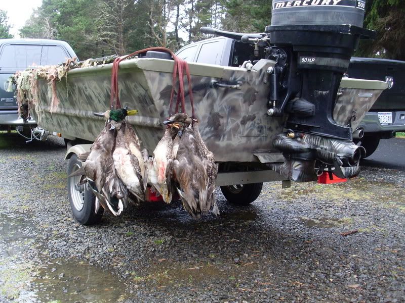

Any longtail 23hp and up should work. I think all manufactures offer a rock guard. Longtails are not the best when quick precise turns are required for navigation through rapids or around rocks in a swift current. A small SD with a rock guard might be a better fit in these conditions if the water is not less than a foot deep. A SD has problems with a hard bottom and shallow water.
I hunted in these conditions in Oregon. The guy I hunted with had a jet foot on a 50hp outboard. This setup worked really good. This is a picture of the motor foot -
http://i243.photobucket.com/albums/ff12 ... 1266195789
